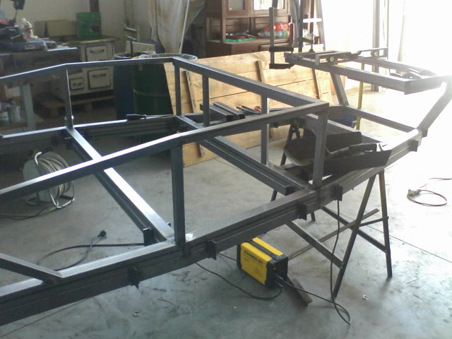

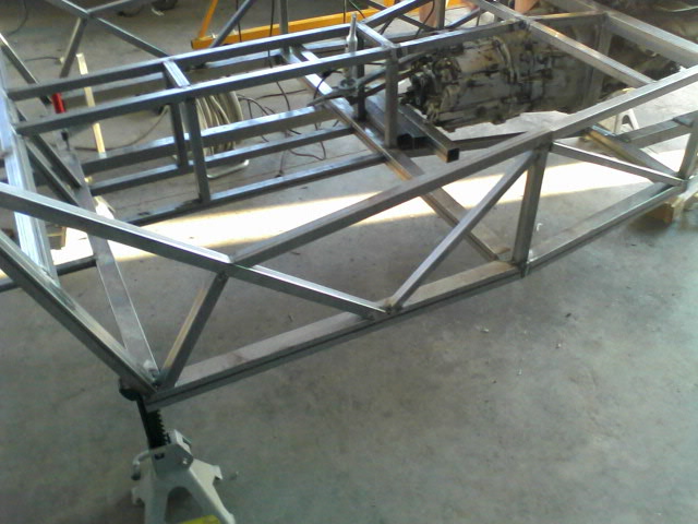

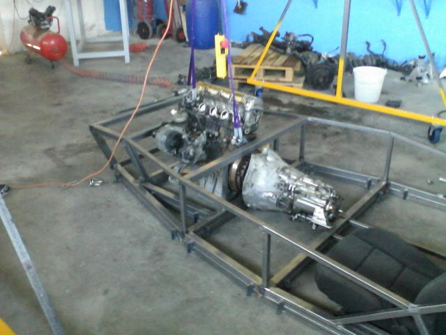

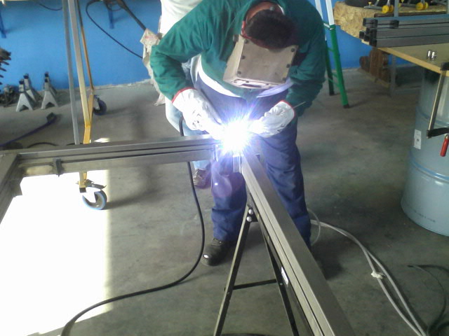

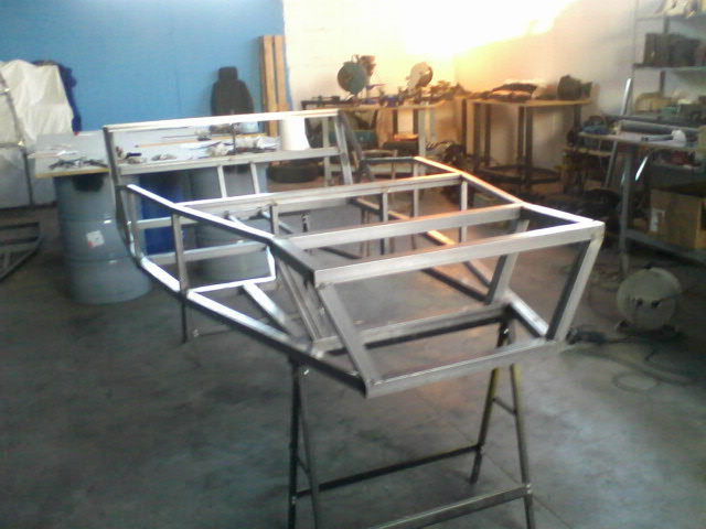

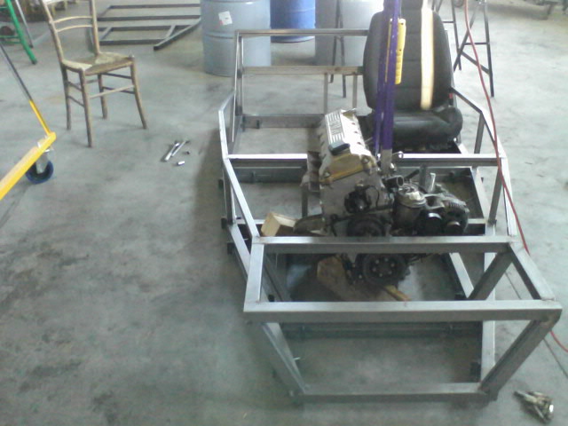

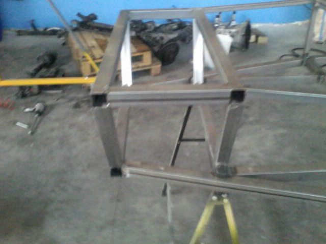

some photos of my seven:
welding......
welding......

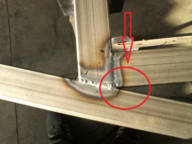

Wow! TIG welding, nice.
But as with sharp (acute) angles?
hipertech
Posts: 21
Joined: Tue 2012-Sep-25 11:11
Location: Vilnius Lithuania
Re: seven hipertech
Post by hipertech »
In the angle welding with MIG...... It' s not possibol with tig..........
Re: seven hipertech
hipertech wrote:In the angle welding with MIG...... It' s not possibol with tig..........
Could be better Tig welding. Is look like fisrt or secont time hoold torch. Sharp angles can be weld with Tig, just need more practice. But with a mig would be better becausebecause less deformed metal

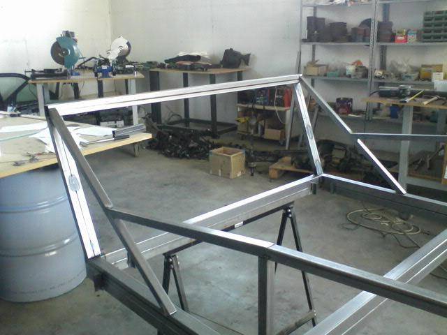

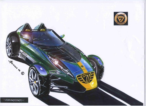

my idea
my idea
Re: seven hipertech
Avoid using lotus 7 characters, it's illegal
Re: seven hipertech
I've seen Italo Sciacca's designs in CKC magazine. Is he a friend of yours?
Nice design, but I'm not sure about using Caterham's "7" logo on the grill.
Re: seven hipertech
Also, looks like headlight viewing angles might be a problem.
